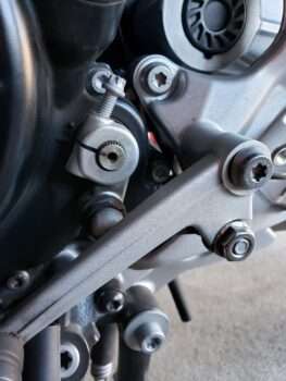

Set screws (shown extended to allow application of threadlock agent) must be fully retracted during initial fitment of adapter’s mounting pin. They are then deployed through small holes in the adapter to stabilize it against the bracket, preventing any wiggle. Clever.

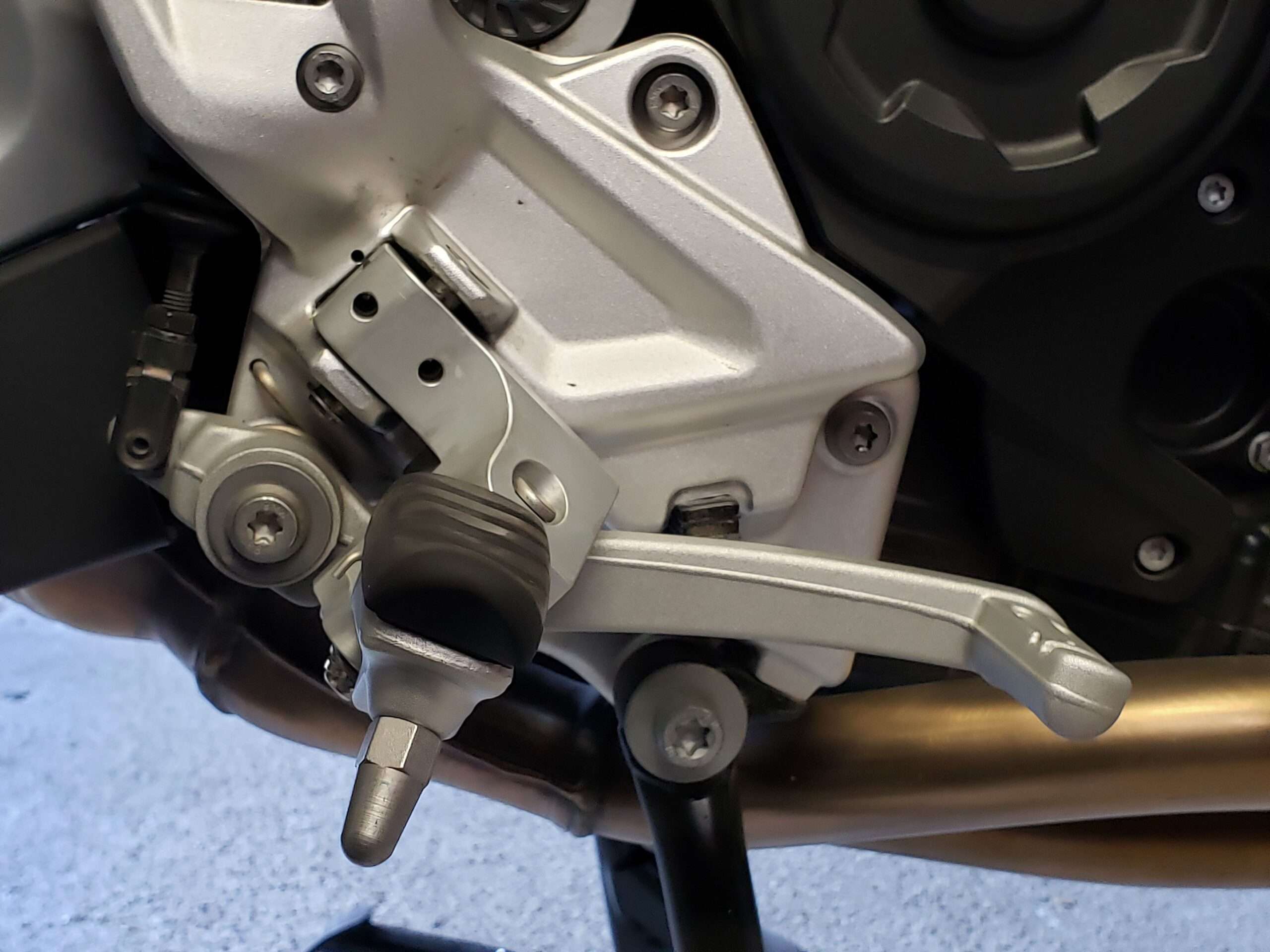

Here’s how to lower the F 800 GT’s brake pedal. First, loosen the locknut on the master cylinder plunger; it’s the hex nut on top of the clevis attached to the pedal. Now the plunger can be rotated and its threads will move it in and out of the clevis, altering its effective length. You can probably do this with your fingers, but there’s a small hex shape for a wrench at the top of the exposed plunger shaft. If the pedal is relocated lower, the plunger will have to be shorter or it would activate the brake in the pedal’s resting position. The plunger is shortened by turning it so its threads draw it into the clevis. It should not be screwed in so far its tip contacts the pedal tab within the clevis. Before making any adjustment, rotate the rear wheel by hand with the bike on its center stand so you have a sense of how much effort it takes to turn it in its “free” state (you may be surprised by how much friction exists in the system before the brake adds more). Also note how far the pedal must be depressed before you feel more resistance to wheel rotation as the pads engage the disk. Now go ahead and screw the plunger further into the clevis so the pedal has room to go lower without activating the brake.

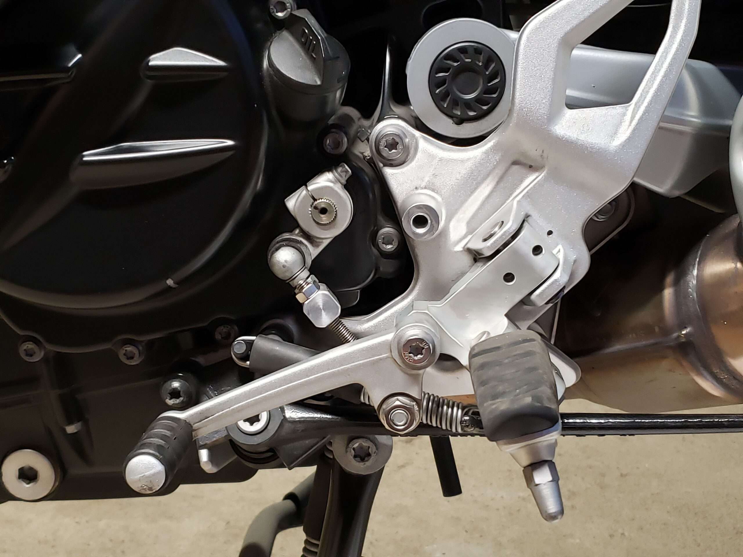

New shift linkage from above. Note shift lever’s relocation to the adapter instead of the boss on the OEM bracket.
You’ll notice there’s a problem: No matter how much more room you give the pedal to go lower, it still returns to the same height, defeating your purpose. There’s a stop built into the nearby bracketry where a slender tab extending inboard from the pedal arm comes to rest. To hold the pedal down in a lower position, the relationship between the stop and tab must change. It’s much easier to make the tab taller than to lower the stop (which also incorporates the brake light switch, so lowering it would either negate the switch or require very complex restructuring). I used wheel balancing weights to increase the height of my tab. They’re sturdy, just the right size, and have a strong adhesive backing to keep them in place. A stack of two yielded an increased tab height of nine millimeters, which put the pedal tip where I wanted it; your preference may be different. Keep in mind you can’t adjust the pedal much further than this, as there’s only so much change possible at the plunger. Also, whatever you use to increase the tab height must extend the full length of the tab to activate the brake light switch, which is nearly invisible up inside the bracketry.
Left side installation complete.
