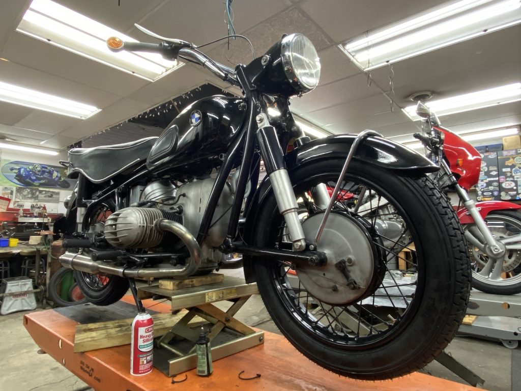

Arrived at Motoworks about 9; Brooke and Jinks were sufficiently impressed by the story of the R 60/2. When taking off the rear wheel, Jinks noticed (and Brooke confirmed) that the swing arm wasn’t properly centered; we made a note to adjust that before finishing.
The wheels are nice and true. Paint is peeling off the rims a little in places, but it’s not bad. No trouble getting the Metzeler Block C tires and heavy-duty Bridgestone tubes on. They have a tire machine like George’s, a little smaller maybe. Less intimidating.

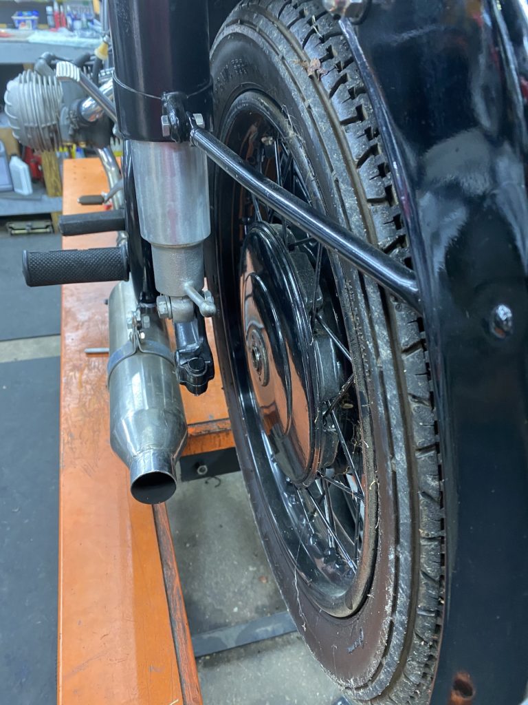

We rocked the center stand onto a board and raised the front end to get at the front wheel. It was a bit fiddly to get off, but just because of the brake assembly.

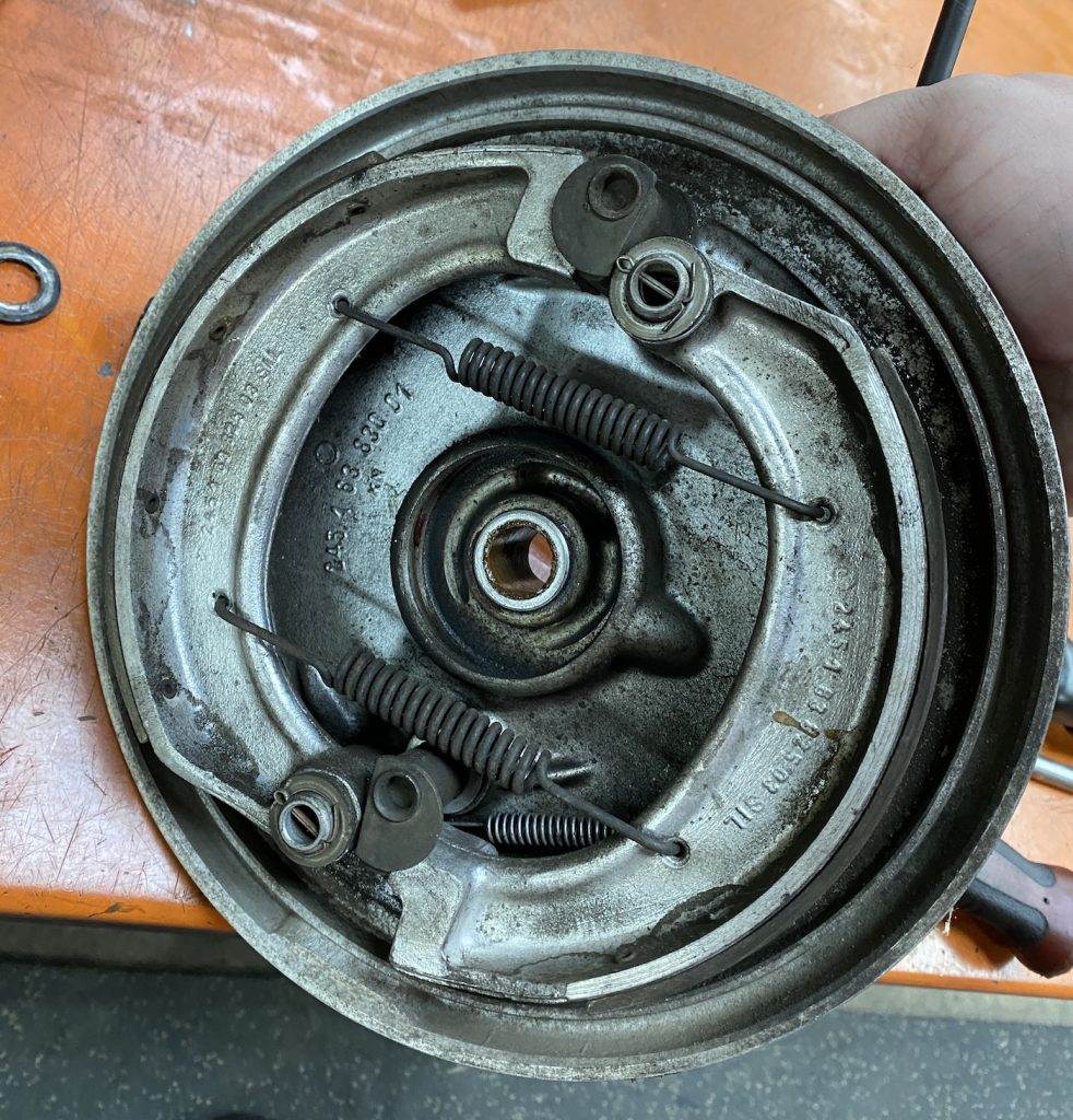

Both brakes are clean and sufficient on the insides, though the linings will need to be replaced eventually. We spent a fair amount of time on the front brake; Jinks didn’t like its operation and showed me how one of the pivots was stuck. That meant what little braking power there would be with the 60-year-old double-leading-shoe system would be maybe half of what it should be. It took about 30 minutes to get that unstuck and the cable properly adjusted. Each “leading shoe” has a pivot, and the pivots have to move bam-bam, one right after the other instead of at the same time. I’ll definitely have to study up on how to properly adjust them; Jinks did it quick and easy but he does it all the time.  The brake cable might not be correct; it’s a bit too long and was improperly routed. The clutch cable appears to be a little too short and is also improperly routed. Easy enough to address.

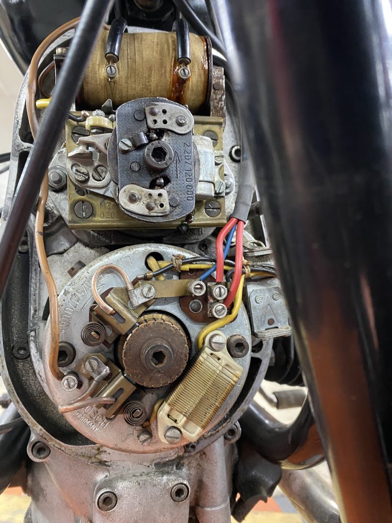

They wanted to pull the front cover and look at the magneto and associated bits under there. I decided to go ahead and order all new components from EME through them and just redo the lot. The magneto itself – the coil, that is – is drying out and starting to leak some kind of goo. The spark plug wires were stiff – old no doubt – but that means some measure of electrical resistance in a system that relies on the wires having no resistance at all.
